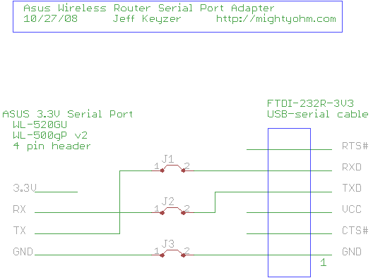

Pessoal depois de andar a ver tutoriais ainda não fiz nada ao router porque tenho algumas duvidas...
Para conectar o router ao PC diz me para usar um FTDI 232 - 3V3 no site da mightyohm.... Neste tutorial: http://mightyohm.com/blog/2008/10/building-a-wifi-radio-part-3-hacking-the-asus-wl-520gu/
Step 3 – Connect your PC
The FTDI-232-3V3 USB to serial adapter cable provides a handy way to add a 3.3V TTL level serial port to a PC or laptop.  The cable has a flat connector on the serial end that can plug directly onto 0.1? male headers like the one we are using on the router.  Unfortunately, the pinout of the FTDI cable (given in the datasheet) does not match that of the router.  To resolve this, you have two options:
Shown here are the cable and adapter installed on the router.  Make sure the ground side of the cable is connected to the pin on the header that is opposite from the fat angled trace (the 3.3V line).  Ground is the black wire, on my adapter I marked this with a black dot so I won’t forget and plug it in backwards.
Mas neste tutorial eu vejo que eles conectam directamente o router ao arduino... http://takenapart.com/?p=3
E eu queria saber era se afinal conecto directamente o arduino ao router ou conecto por serial? e gostava de saber se tenho que ligar os fios trocados do router para o arduino...o TX-liga com o RX e vice versa??
E gostava de saber se para depois alimentar o router ligo-o aos 3v3 ou aos 5v?
